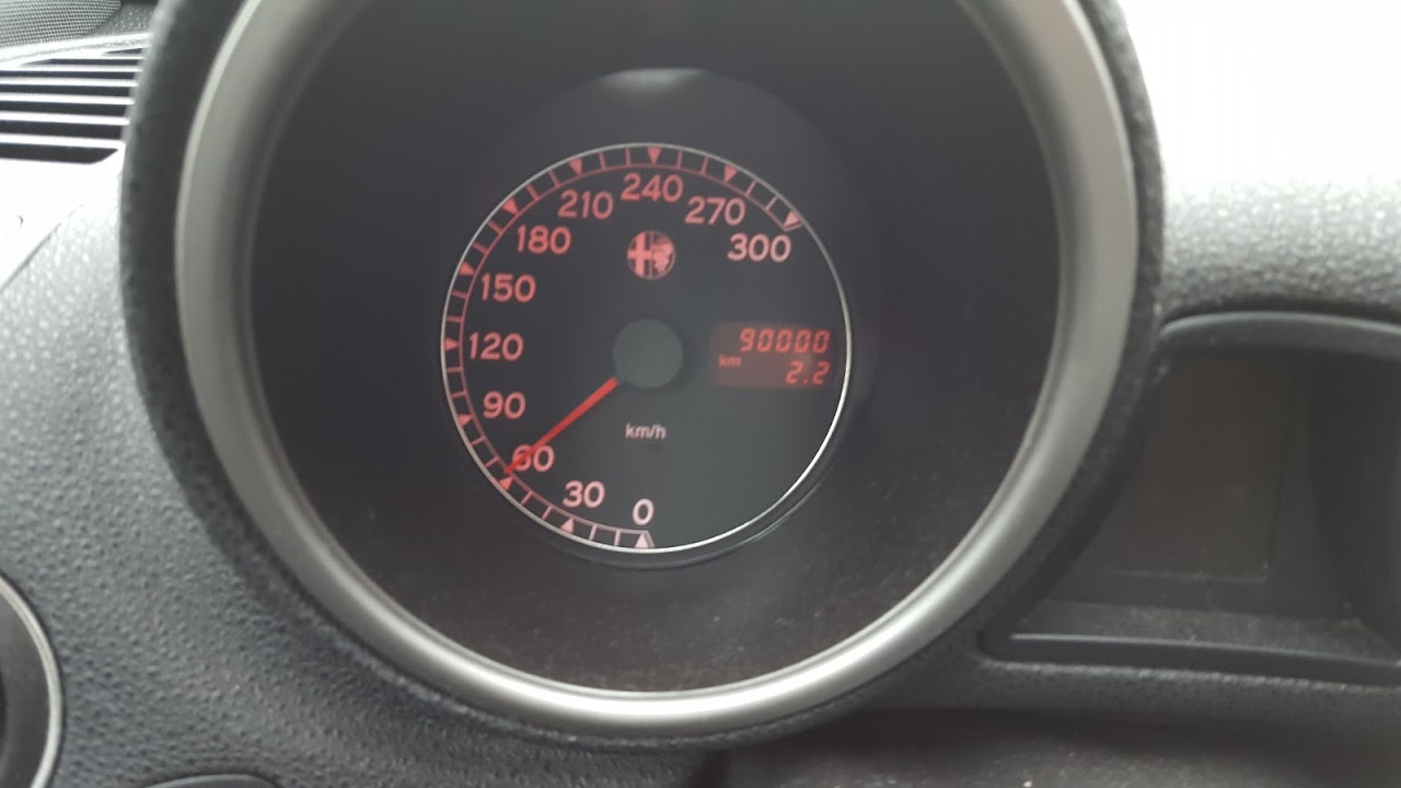

Posted: 26 Oct 2015, 10:25
Sellised ümmargused juubelinumbrid. :hi:
